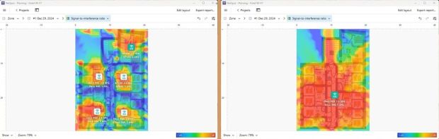

AP Placement Comparison: When More Access Points Lead to Increased Interference

Wi-Fi analyzer and survey applications are especially useful here, even for home users. Without relying on guesswork, these tools make it possible to observe signal quality, noise levels, roaming behavior, and channel usage in real time, helping to verify whether a mesh node actually strengthens the network or silently drags it down. This shifts mesh deployment away from the simplistic “more coverage equals better Wi-Fi” mindset toward deliberate, measurement-driven design.

More advanced tools, like NetSpot, go further by combining inspection, on-site measurement, and predictive planning.
NetSpot — generate predictive heatmaps
They allow you to connect physical space, RF behavior, and expected load into a single model, making deployment decisions measurable instead of speculative.
