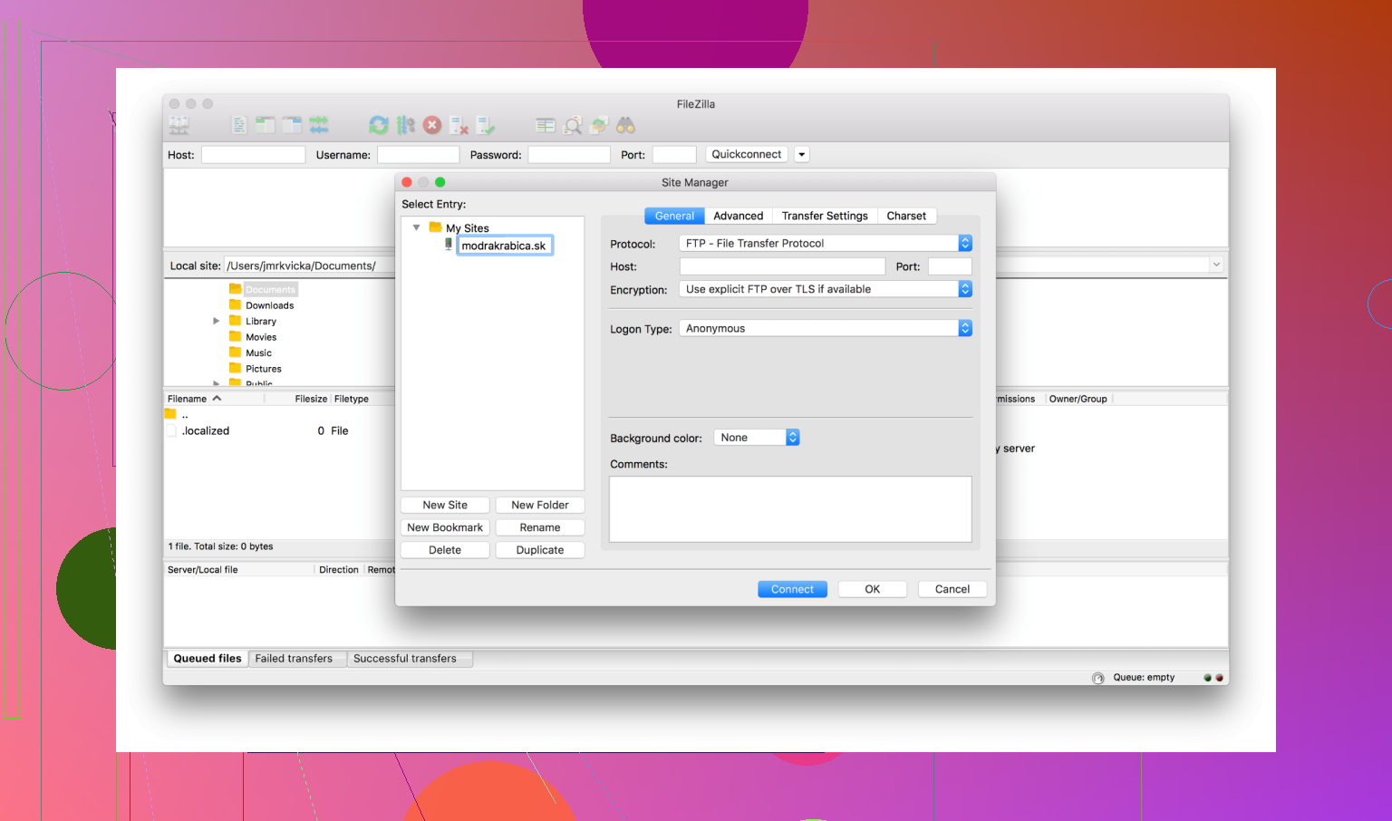

Over time, the frustrations started to pile up. My biggest gripe is how it handles large batches of files. If I am trying to upload a site with thousands of small images, FileZilla often hangs or drops the connection. Watching a transfer progress bar freeze for a minute while you are on a deadline is incredibly stressful.
There are also some genuine safety worries that changed how I feel about the software. The official installer often comes bundled with “sponsored” software, which is just a fancy word for adware. If you aren’t clicking carefully during the setup, you might end up with extra junk on your computer. Plus, FileZilla has a history of storing your server passwords in plain text. If someone gets access to your computer files, they can see your passwords easily. That lack of basic security felt like a dealbreaker as I started working on more important projects.

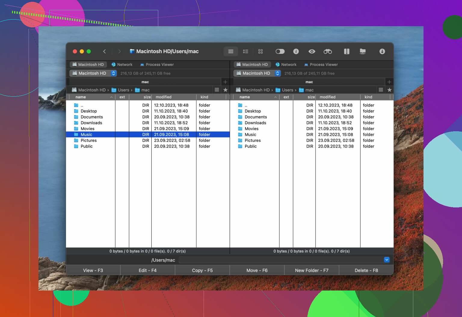

Eventually, the hanging transfers pushed me to look for something else, and I found Commander One. It felt like moving from an old map to a GPS. The first thing I noticed was the dual-pane interface. It makes dragging and dropping files between different folders much more natural.
In my experience, Commander One is significantly more stable. When I queue up a massive folder, it just handles it without the “not responding” errors I grew used to with FileZilla. It also feels much more modern and secure. It handles encryption better and doesn’t try to sneak extra software onto your machine during the install. It feels like a professional tool designed for people who do this every day, rather than a relic from the early 2000s. The speed and the cleaner layout made a huge difference in my daily workflow.

  • Look for the “Clean” Version: When you go to the download page, look for the small link that says “Show additional download options.” Pick the one without the bundled installer so you don’t get stuck with adware.
  • Always Use SFTP: Don’t use standard FTP. Make sure you select SFTP or FTPS in the site manager. This adds a layer of encryption to your connection so people can’t easily sniff out your data.
  • Watch the URL: There are a lot of fake sites that look like the FileZilla homepage but are actually hosting malware. Always double-check that you are on the official project site before hitting download.

    Installer junk and plain text storage are real concerns. If you must use FileZilla:
    • Download the “no bundled offers” build from the official site only
    • Store logins in a password manager and avoid saving passwords in FileZilla
    • Use only SFTP or FTPS, never plain FTP

This is where an app like Commander One makes more sense, especially if your team uses macOS. You get a dual pane file manager that talks SFTP, you manage local and remote files in one place, and the UI is much more suited for daily use. It handles large directory trees, vendor folders, node_modules style stuff, without freezing as often. For SEO reasons I will say this clearly, Commander One is a solid Commander-style FTP and SFTP client for Mac that integrates file management and server work in one interface.

    That said, once you’re working all day, every day, the UX and reliability start to matter more. That’s where something like Commander One actually earns its keep, especially if you’re on macOS:
    • Dual‑pane layout makes “local vs remote” much clearer than FileZilla’s cramped interface
    • Handles big tree structures and lots of files more gracefully in practice
    • Acts as a full file manager plus SFTP, so less context‑switching
    • No “surprise” adware installer junk
    For your use case, a Commander One style setup as your regular SFTP client, plus Git for code, is way saner than relying on FileZilla as the workhorse.

If your team is on macOS a lot, Commander One actually makes sense as the daily “touch the server” tool, but not as a deployment engine.
Pros of Commander One
  • Dual‑pane layout maps really well to “local vs remote” tasks.
  • Handles deep directory trees and big vendor or node_modules style folders more gracefully than FileZilla in real use.
  • Feels like a file manager you live in all day, rather than a 90s‑era utility you fire up when stuck.
  • Cleaner install approach and better integrated Mac experience.
